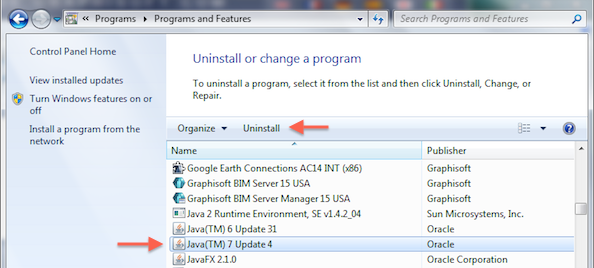

ARCHICAD 11 - ARCHICAD 15
If you are installing ARCHICAD 11-15 and Java version 7 is installed, the installers (or un-installers) of ARCHICAD won't work. To make them work:
  • Temporarily uninstall the v7 Java version
    • open Control Panel
    • Add/Remove programs
    • Remove Java 7
  • Install the one from the previous list for the version of ARCHICAD you have (in most of the cases when you install Java version 7 (1.7) the old Java version is kept, so you only need to remove Java 7 in order to make the GRAPHISOFT installer work)
  • Install/Uninstall the ARCHICAD version
  • After that you can reinstall the original Java version - e.g. from http://java.com/en/
