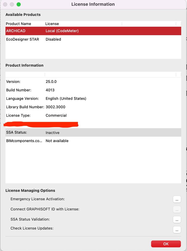

joelsdg
Minh,
Not sure if this is pertinent, but I also noticed under License Information, at the very top, under the columns Product Name I have Archicad.  But under License, I have  Local (Codemeter).  I am using a software key.   I thought Codemeter was for the physical/hardware USB keys.  Could this be part of the problem?

Minh Nguyen
Graphisoft Alumni
Graphisoft Alumni
Hi Joel,
Thank you for the screenshot! This explains why the error about SSA shows up: Archicad does not recognize this license as an SSA license. I would suggest contacting your local support for further investigation, as this might involve multiple parties to identify where the problem could be.
