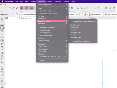

Hard to distinguish buttons in activated state - fixed
Affected version(s): All Archicad version(s) | Severity: fixed in an update | ID: DEF-5515
Issue
Highlights are in the same color as defined under system preferences/general/highlight color instead of grey.
Solution
This bug is already fixed in:
  • Archicad 25 Update 3 (50xx build) and Archicad 25 Solo Update 3 (50xx build)
  • Archicad 26 (30xx build) and Archicad 26 Solo (30xx build)
