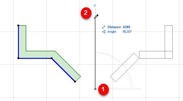

Mirroring creates a mirror image of the selected elements.
  • Select the elements you want to mirror.
  • Invoke the command via Edit > Move > Mirror …
or select it from the context menu or the Pet Palette.
  • Define the mirroring axis with two clicks, as if you were drawing a line.
  • After defining the first axis point, move the cursor. You can immediately see the mirroring axis and the resulting contours of the chosen elements.
  • The mirrored elements will be placed after the second click.
