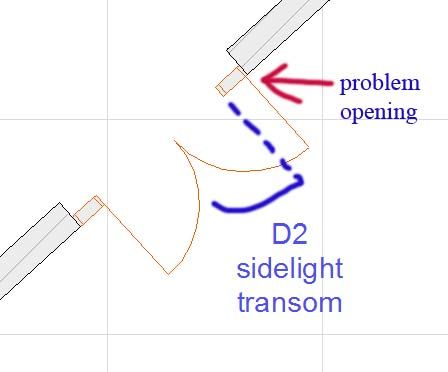

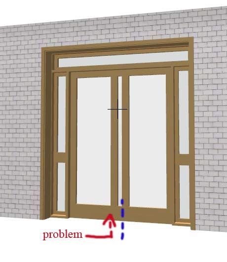

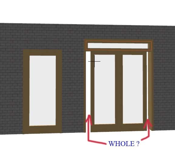

I have any problem in 2D and 3D preview design Door library in AC11
in 2D floor plan can't edit door panel and no syncronism with edit 2D to 3D preview
My AC10 no problem.
What is bug in Library door & window AC11?

Try to use the Door Settings, rather the 2D editing.
Make sure the door is devided 50%.
Make sure you choose the right door.
What is the name of the door part you are using? It is impossible to check out the problem unless we know what to look at.
The settings can sometimes be confusing and some doors may have bugs. Try reseting it to its defaults (change to another part and change back) and then try adjusting the parameters again.
I've just noticed that you are having the same problems as I do with transom doors that don't work correctly even at the default settings. (See here for my moan!)
Has anyone got any further with working out what the problem is yet? I assume one of the macros is not doing what it is meant to, but I can't tell from looking at the script. It's far too complicated for a mere mortal like myself to decipher!
