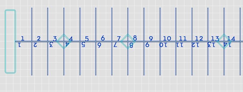

Trying to create parking back to back with text not upside down, see the image.
Thanks
Erika Epstein
None of the 3 parking library parts do everything it should. The one you are using is the only one that can slope to follow the ground, but you are stuck with stripes on all sides, or at 4 corners or none. None of these are standard striping conventions around here.
The other two can't slope, but you can move the text and/or rotate the text orientation.
Make up your mind which is most important...or add the parameters you want to the one that comes closest.
Yet another example of inadequate library parts.
