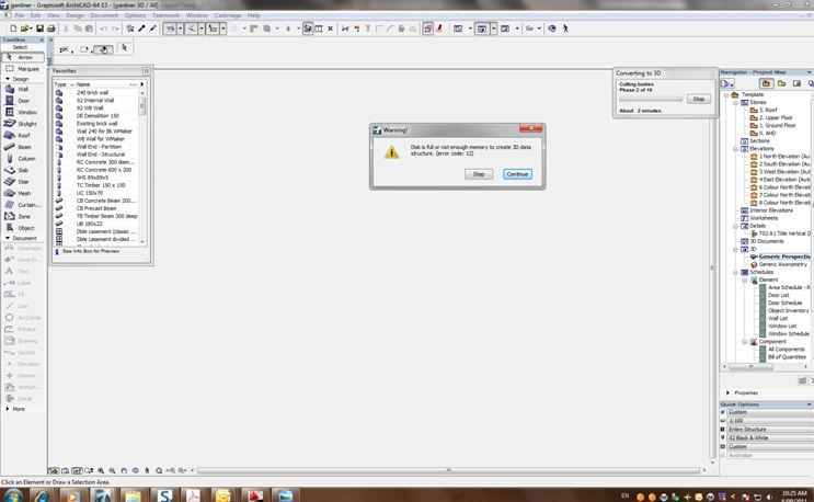

Archicad 13 (error code 12) disk is full
disk is full or not enough memory to create 3d data structure. (error code 12)
Archicad 13 comes up with this error when going from plan view to perspective.
can anyone help me with this problem?

Sounds like a memory problem. I assume that you have checked your the available space on your hard drive.
Either your physical RAM or the 32bit address limit. If it's the former, buy more. If the latter, upgrade to ArchiCAD 15 which is 64bit.

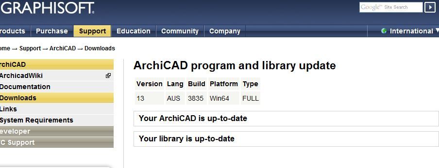

i have AC 15 and tried to install it a couple of weeks ago but when i went to open it, AC 15 just hangs at the start up.
i checked if my archicad was up to date and it is.

Timothy wrote:
also as far as im aware i havnt installed the latest hotfix (7) - build 3826
its currently d/l
You have build 3835 so all is up to date there.
They must have snuck in a hotfix 8 without me realising.

So we've been running AC 13 With the latest hoxfix and we are still getting the 'disk is full or not enough memory to create 3d data structure. (error code 12)'
this is driving 2 of our workers crazy as they have to shut down AC13 and restart it again.
does anyone have any suggestions?
Does this happen every time, or just sometimes?
How complex is your project? How many and how complex are objects placed in it?
Is ArchiCad able to produce the perspective view if you only select and try to preview a part of the project?
I have no experience with the 64 bit version of Archicad. And you computer seems strong enough.
Still... it may just be a problem of too many too complex objects. Try lowering the polygon count - lower the number of complex object, lower the magic wand settings, so that, especially meshes don't end up with too many points...
