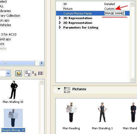

Can someone please tell me if it's possible to use my own pictures (jpg) as bitmaps in archicad, and if so........how???
Have tried, and the photos has been added in the library manager as other objects, but they're impossible to get when I'm in the dialog box for people? What am I doing wrong?
5 Replies 5
Agnes,
In "People Bitmap 10" object, select the Custom option and enter the name of your image where shown below.
