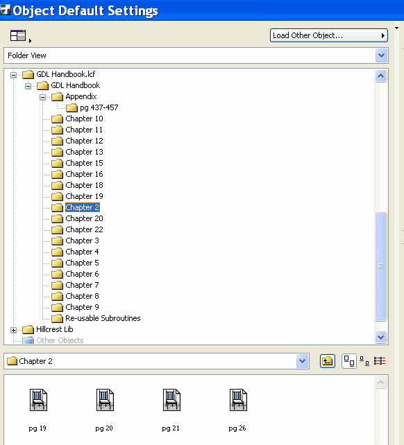

Finished understanding to end of page 12 and now have a screen
with my new object named, in a directory of a loaded library I had already
for my current project that has the subtype as shown in lower right corner of page 12. Great so far. But, Ok now I'm expecting to continue on with the that screen, but page 13 jumps to barrel object. Felt a little disjointed here.
Like I was a missing page in my book.
Ok, now I'm back on tract on page 14 and especially like the explanation of "Formatting the Parameters List".
Now I'm up to middle of page 16, Subtypes, Parameters and Temp Objs.
Now it goes back to talking about the slide object again and it's subtypes.
But forging ahead and get a new subtype (I called myfirstsubtype) as explained in the 5 steps at the bottom of page 16. I'm learning. I like it.
Now will start with page 17 and try real hard to do the proverbial head wrap thing for a while before I get back here again.
Andrew, hope that helps, or maybe it's just me.
Update.
I get how to create the new subtype from previous examples however;
When I select Subtype "Site Improvement" as shown on page 17 (1.)
I don't get the LIST as shown in the dialog box on lower right of page 17.
What I get is shown in my attached image no matter what combination of choices under site improvement (or Play Equip) or site improvement itself I highlight and choose.
I'm on 12 full, so don't understand what I'm missing.
Also;(related?)
In item (2.) of 5 on page 17; "Add parameters to the object as illustrated". What "illustration" or words(?) is that referring to?
thanks
lec, it looks like you've done everything correctly - did you click on the Select button?
Now you just need to add the extra parameters shown in the illustration.
Admittedly you may need a magnifying glass to see them! However all of the examples etc. are available as a downloadable LCF file, so you don't need to work through them all manually, just so as to get the idea.

Hi Andrew
Thanks for the kind words.
Got the pc zip file from web site with no problems.
Unzipped and loaded the .lcf into a test project I'm using.
Browsed to my Handbook dir and went to Chapt 2 folder;
All ok so far, except there is no page 17 listed in Chpt 2.
I looked in some of the other chapters but did not see it.
See attached screen shot of what I get.
