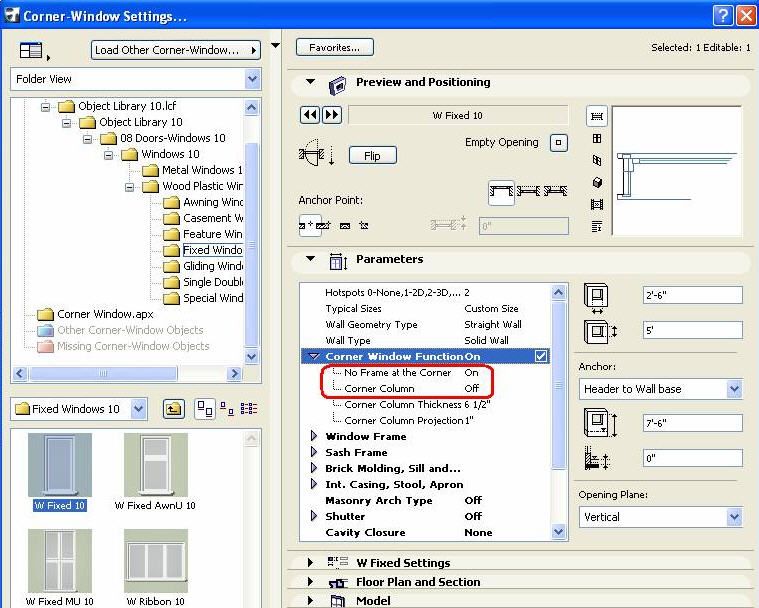

How do I make a corner window with no column where the windows meet? I know I can click on the box that makes the corner windows empty, but then the frame is gone.

Did you try searching the forum, there are lot of discussions on this. I hope attached image will help you achieve what you are looking at.

I dont have that option. Maybe its because I have a Mac?...

I don't think so, because the library should be the same to windows and Mac. That image i posted was for archicad library v 10, that image was from an old discussion on this forum. I didn't check if it still the same for the new versions of archicad.
Are you using ArchiCAD US Version?

I am using the US version.
However I got it to work. I tried a different window type and it worked, so I guess it was just the type of window I was using.
