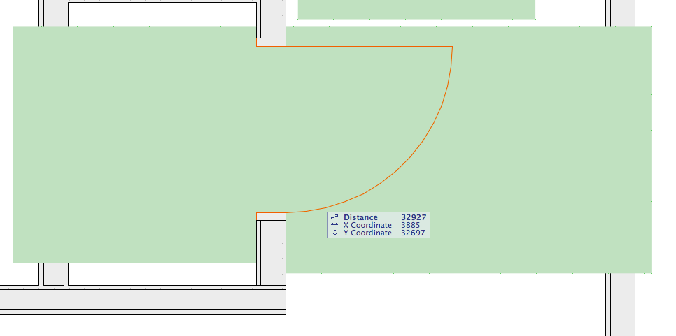

Would it be possible to switch off the green path around doors as show.
Thanks in advance.
1 Reply 1
Document > Set Model View > Model View Options > Options for GDL Objects ... uncheck "Show Minimal Space of Furnishings and Doors". You also have options for minimal space in door's settings.
