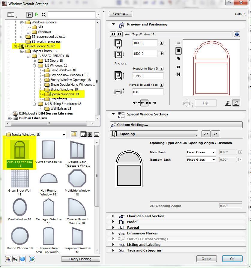

Or just use the 'Arch Top Window' object in the standard Graphisoft library?
