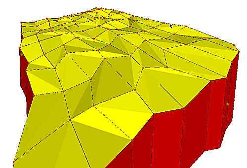

I've got a gdl terrain model (developed as an experiment for something else I'm working on) however I'm not quite sure what it would be useful for?
All the points are stretchy in both the x-y and the z directions, and the triangulation between the points is automatically worked out depending on the position of the grid.
Ok - I tried at 20x20 and it was s-l-o-w in 3d on my machine. This is at 10x10; should work OK on most boxes.
Ideas anyone??
TIA - Stuart
