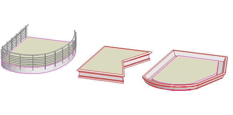

I've made some accessories, isn't difficult but now I've not time (perhaps next week).
below a little step
CU mirco

Hi Ben,
the ArchiCAD accessory technology can be used with slabs, roofs, walls and zones as well as drawing 'on the fly' the polygon shape (or using the Magic Wand).
Of course the host element (slab. roof, wall, zone) can be hide (layer settings) and the position of the 'child' element (I mean the accessory element, in this case the deck) can be freely defined by the user using the host element shape as reference.
ArchiCAD accessory technology is a very good way to collect data info from your project and use them as base for your parametric objects.
