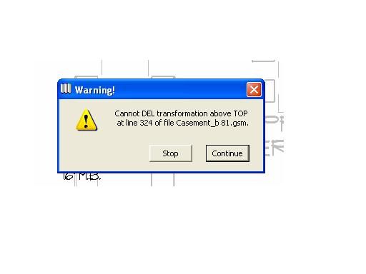

GSM at Line 324
sorry didn't know what to call this one....this error message occurs on a particular project that is in teammate....it only occurs when several people are on the project....if someone is logged in alone and as a team leader the message does not occur....help...
1 Reply 1
someone showed me a similar problem a few hours ago... turns out they were loading the old 8.1 libraries along with the 9 library, and the part was referencing the old library.
We removed the old library and just used the v9 library - everything worked fine... except for the way the parts are drawn in elevation/3D. See the revived thread http://archicad-talk.graphisoft.com/viewtopic.php?p=30721#30721
HTH
Wes
