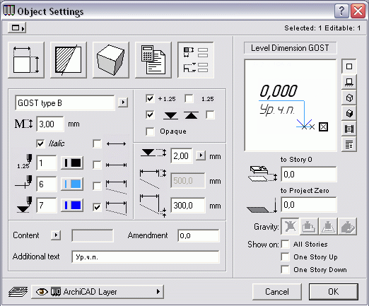

The problem consists that in ArchiCAD there is no opportunity to add a new pattern in the tool "Level Dimension". In Russia other standard for the image of the "Level Dimension". The state control of check of the design documentation demand to correct the images of the "Level Dimension" made by means ArchiCAD. Therefore the Russian architects working in ArchiCAD use a library part.
The library part uses global parameter SYMB_POS_Y.
If the drawing of a section is moved concerning the global beginning of coordinates it is necessary to bring in updating of this displacement.
It tires. It is better to use "User origin".
Interlocutors can rebuke: "Do not move sections and Use PlotMaker".
I shall answer: "I Deny any infringement of freedom of action".

Then I could, solve a problem(task). Externally it would look the same as in the tool " Level Dimension ".
