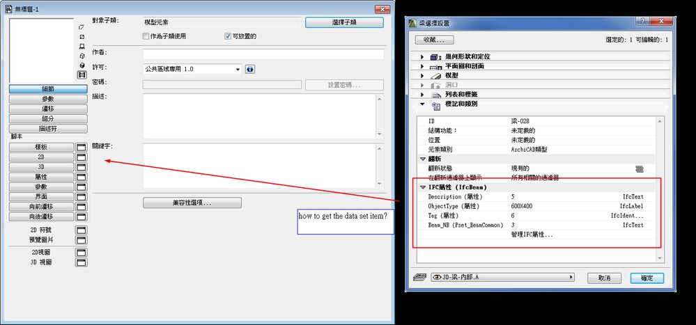

HI ~
I have several custom IFC project data.
That the GDL editor, how to get the data set item?
Request master help answer.
Thanks ~

There is no access to custom IFC parameters from GDL, as far as I know. Others have requested this feature, too.
