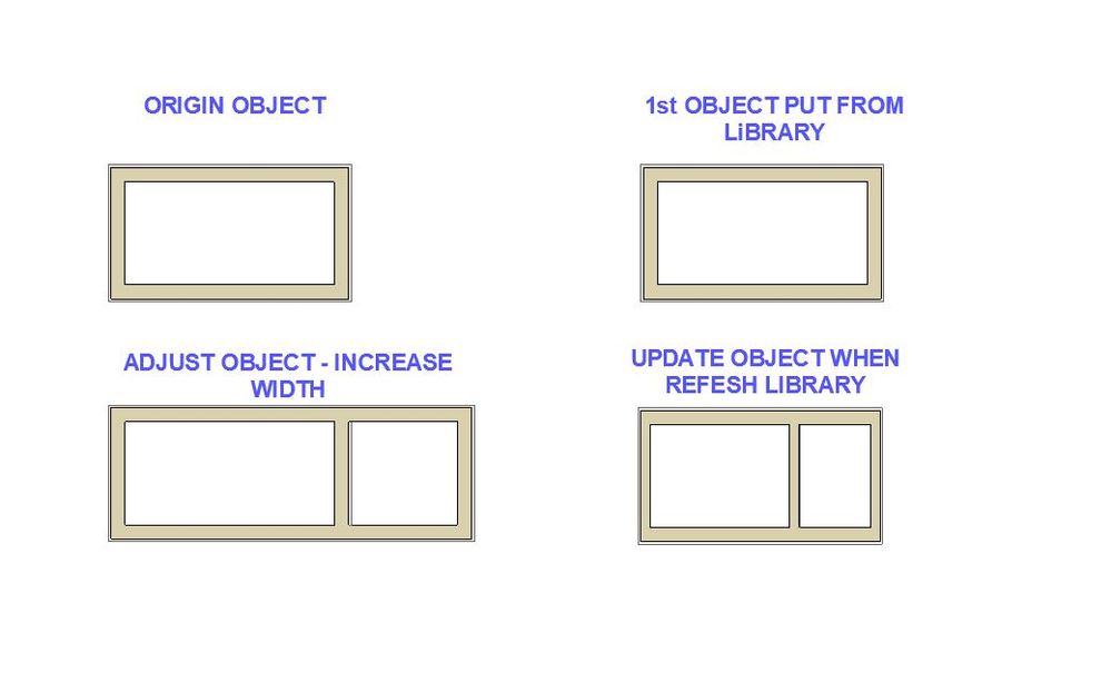

I created an custom object by wall, slab ...etc
I save by save selection as Object and put in PLN file
After that I need to increase the width of object , i will edit the source and save as again with same name in Embedded Library, and refresh status of placed object, but the object didn't change to new size , they only change the form inside and keep previous dimension.

ThanhVuPhuc:
Once the Object is created and placed, the placed A & B values are stored as part of the placed Object, so changing the default values have no effect. You would need to select the placed Objects and change the A & B values in the Object Settings dialog box, or select them, then select another object (in the Object Settings dialog box) then reselect the original object, this will apply the new default values to the Object.

David Maudlin: Thanks, i think it's only way we can resolve that problem, cheers
