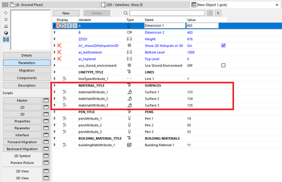

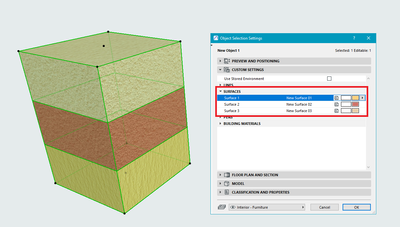

If I create an object from a SketchUp model, it brings in new surfaces in ArchiCAD. If I convert this object to Morph (to simplify some geometry) and save it again, the object retains the original surfaces from SketchUp only in the specific project file where it was created.
For example, three new surfaces are created (or imported) from SketchUp, and ArchiCAD automatically assigns them new index numbers, which are locked with the object.
When I export this object as a GSM and import it into another project, the surfaces show as missing because the new project hasn’t used index numbers 133, 134, and 135 yet. In another project where these index numbers are already used with different surfaces, the object will apply those different surfaces instead. TO retain same surface each time i have to copy this object from one contained file and paste to new project.
