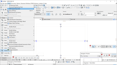

Hi everybody,
I am need a customized MEP object, so I used this technique in AC24 PT:
https://helpcenter.graphisoft.com/user-guide/128814/
But, for any reason this option is unavailable for me. All others MEP tools are working properly.
Anyone had the same problem?
I´m sorry if this was not the right place for this topic.
Thanks!

The Help system has a good search function.
https://help.graphisoft.com/AC/25/INT/index.htm?rhcsh=1&rhnewwnd=0&rhmapid=#t=_AC25_Help%2F081_MEPMo...
Try saving as MEP object from the 3D window.
Seems it doesn't work from plan.

@andrecarmo Have you tried to find it through Design > MEP Engineering Tools. I don't have the version 24 installed on my computer, but try this pathway:

@Martin Jules all the functions work fine except that one. I already used the MEP modeler with no problems until I needed a especific part that I couldn't find anywhere. Anyway thanks for the reply.

@Barry Kelly you are absolutely right. I tried several times, all in 2D plane. The only problem here is that I need a pair of glasses 😅
Thank you!!
