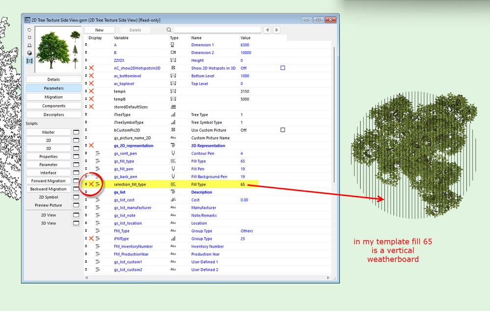

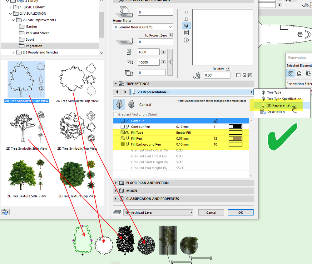

2 new trees in the 'vegetation' folder (the new 'texture' trees in the library update 1), also have the same problem.
No control of the background fill and can't be re-set in the mapping table.
Can we please get these library parts fixed?
This was brought up in the Tech preview for 28.
Update 1 of library 29 and we still have the same problem.
I am sure I am not the only person with a modified template where fill 65 is no longer an empty fill.
The background fills in the objects are hidden, so we can't adjust them in the object settings and the Mapping Value Table adjustments don't work with hidden parameters.
I can extract the library pack and then the library container file and fix it myself, and then re-save the container file and library pack, but then I have to replace it on every machine.
And then as soon as there is a library update, I have to do it all over again.
