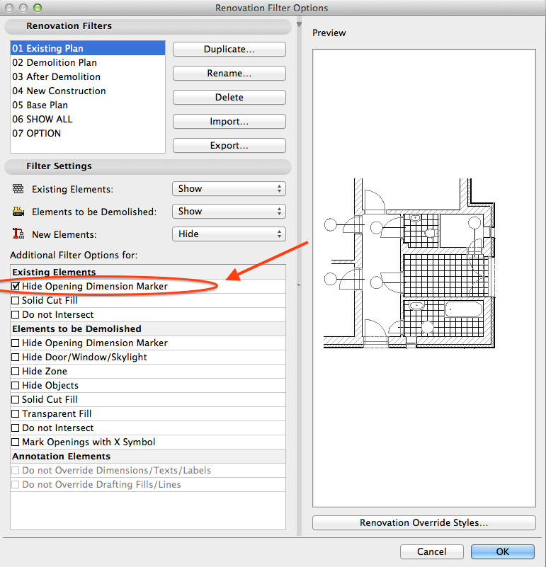

Can't see your screenshot, but have you
checked your "Renovation Filter Options"?
Marc Corney, Architect
Red Canoe Architecture, P. A.
Yes, I figured it out, and it was a renovation status issue. I forgot to set the door as "New" so the view was not showing existing door tags. Thanks!
