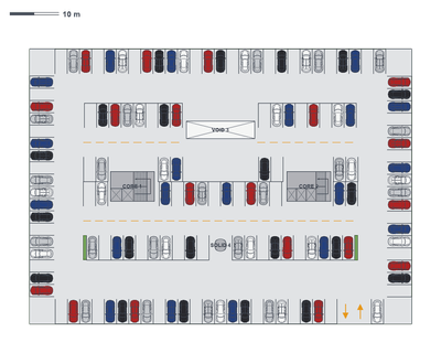

archiParkingLayout: draw your site as a polygon (drag the corners) and it fills it with surface parking:
  • 90°, 75°, 60°, 45°, 30° or parallel stalls, with aisle widths and one-way/two-way traffic following the angle
  • best fit: rows turn and shift to fit the most stalls, and refit whenever you move a corner
  • a ring road or end lanes so every aisle connects, entrances, and rounded islands at the row ends for turning
  • optional trees (a planted bay every N stalls, trees on the islands), cars in plan and 3D
  • stall count, m² per stall and stalls per hectare in the info block

Hey giza, we've been testing the parking object and it's been phenomenal. Is there anyway to create holes in it? We often have to work around basements with multiple cores coming down and this would be even better if we could get it to calculate around these cutouts.

Hi Kalib,
I updated the object you can download latest version, new options to add cores and voids, you can check the help page for more details: https://www.architools.net/libraries/archiparkinglayout
