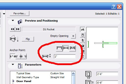

When the door tool places a pocket door into a wall, it places it slammed against one side of the wall, as opposed to centered in the wall.
Any ideas how to center the door in the wall thickness?

Try using the sill placement method and enter the appropriate distance.
Cheers,
Link.
