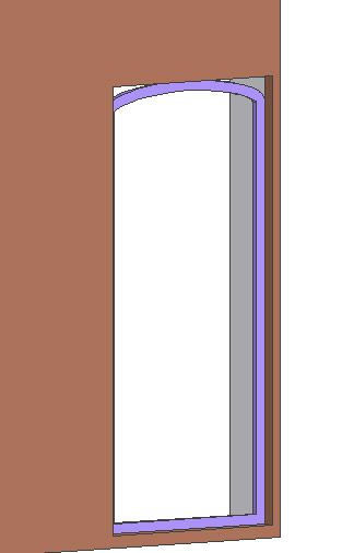

Hello, somebody can-you it to explain me how to change Gdl script to have the
filling of the wall around the curve of the window?
Thank you very much

Hello Xav
How do you do this window ?
Can you paste your 3D Script ?
Do you want that you can change parameter or just be an unique window ?
Do you want it to be compatible with accessory wall ?
If you want that you need to use Wallhole command…

Slab: define a shape of the wall's hole.
In the slab's ID (Label parameters) insert this code:
WALLHOLE
Resave all ( Slab + Wall) into Window/Door object.
CU mirco
www.3dsmile.it
WALLHOLE
CU mirco
www.3dsmile.it

Thanks for your help.. my problem is ok...resolved
