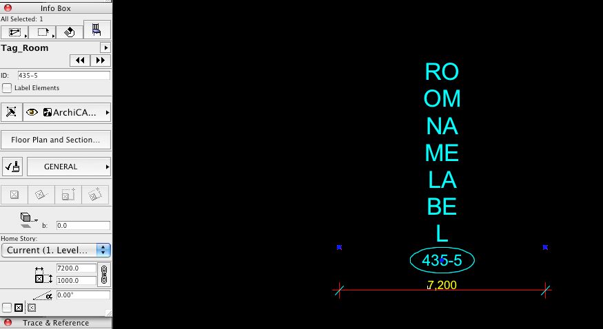

2009-09-18 03:35 PM
Barry wrote:Hi Barry,
It will wrap the words unless the width you specify is too short and then it will have to break the word down as well.
What you have works just fine as you adjust the width.
You have set the width base on the "A" variable (A__=A*1000).
The default for "A" in your script is 1000 mm so the default width of you object text is 1,000,000 mm.
As you adjust the width of the object in the info box then all is good (as in the image below - width set to 80, 60 & 20).
As for the variables in the info box that is not possible unfortunately.
The only text variable you can use in the info box is the ID which you are already using any way.
Thanks for all your help so far! The width issue is really troubling me. The reason I made the *1000 thing was because of the attached image. Despite my blockwidth being defined as "A", and despite the fact that in this image A is 7200, the text is not really filling the outline of the box that it should be. Any idea what's up?
For what it's worth, I would *love* to be able to define A by dragging the hotspots, is there any way to accomplish this?

2009-09-24 09:48 AM
Sorry I haven't been around recently to reply.
Firstly the paragrah line in the 2D script needs amending.
paragraph "roompg" 2, 0, 0, 0, 1
There is something funny with the "blockwidth" variable - it seems to be getting reduced by a factor of 10 for the text but is OK for the hotspots.
That is why the hotspots are wider than the text.
I haven't had time to look into it too deeply and I won't have for the next week or so (sorry).
The object is already stretchy as the hotspots are based on the "A" width.
Or you could add in a moveable (stretchy) hotspot based on a "blockwidth" parameter which you could add into the parameter list (remove from the master script where you have the "blockwidth = A" so then it is independent of A.
If I can I will try to have a better look at it but it won't be in the next week - I am actually going to take a few days off!
Maybe someone else may have a look at it in the mean time.
