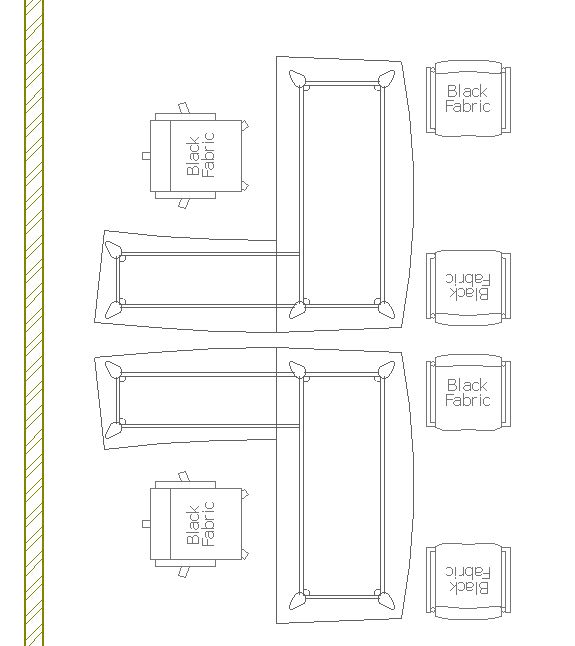

1- I need the text in the chair to stay horizontal even when rotating the chair it self. If I am not wrong this could be done in GDL, there was an exercise in the Cookbook that had something similar.
2- How to setup the text to be scale sensitive.
Thank you.

Chadi,
Just before the text2 command
write rot2 -symb_rotangle.
Remember to write del 1 after the text2 command.
You can find the code for scale sensitive text in
some graphic symbol objects such as the detail-marker.
