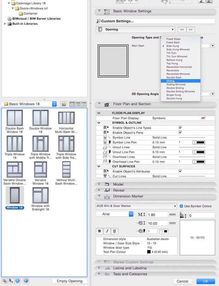

Might be a silly question but I am after a sliding window with 1 fix panel and 1 slider. I can't find anything in the Ozzy library for the world (there are 2 sliding windows there only: 2-sash and 4-sash, and the 2-sash has both panels as sliders).
1 Reply 1
You'll want to use the basic window and choose the sliding or sliding mirrored option from the drop down settings.
