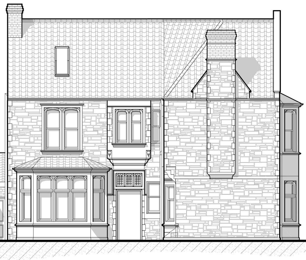

Take a look at OBJECTiVE. Watch the first example clip for an example of modelling stone detailing on a building facade (an example elevation is attached). OBJECTiVE provides tools and objects that allow you to model and edit the building model in an easy and intuitive way, like the rest of ArchiCAD.

Ralph wrote:
....an example of modelling stone detailing on a building facade (an example elevation is attached).
Off topic... but Ralph... I assume the example elevation has some 2D line work?.. the bold outlines?
OBJECTIVE is now on my "WANT" list for Archicad addons.
Cheers, Marc
Marc Corney, Architect
Red Canoe Architecture, P. A.
Ralph Wessel
Yes, I add the bold line-work manually. It's very quick and easy to do, but enormously effective for adding 'depth' to the drawing.

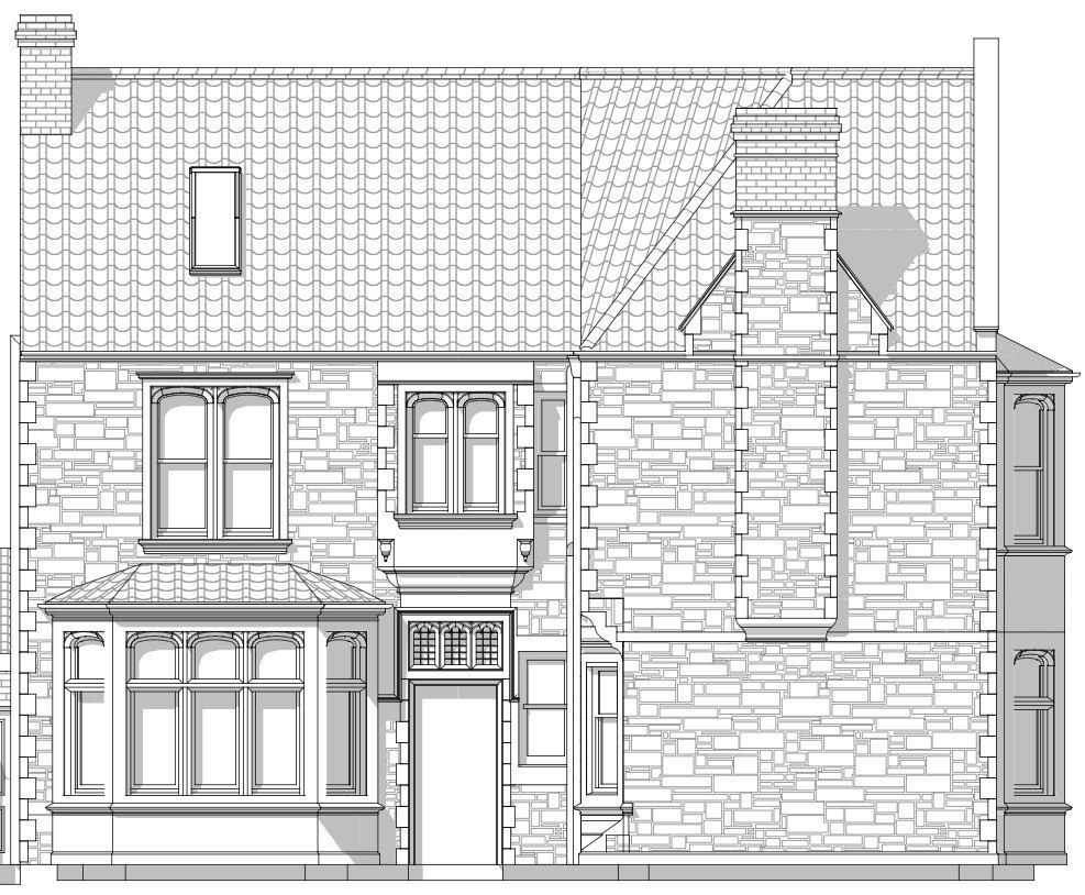

Ralph Wessel
For reference, the attached image shows the same elevation with all 2D elements removed.
