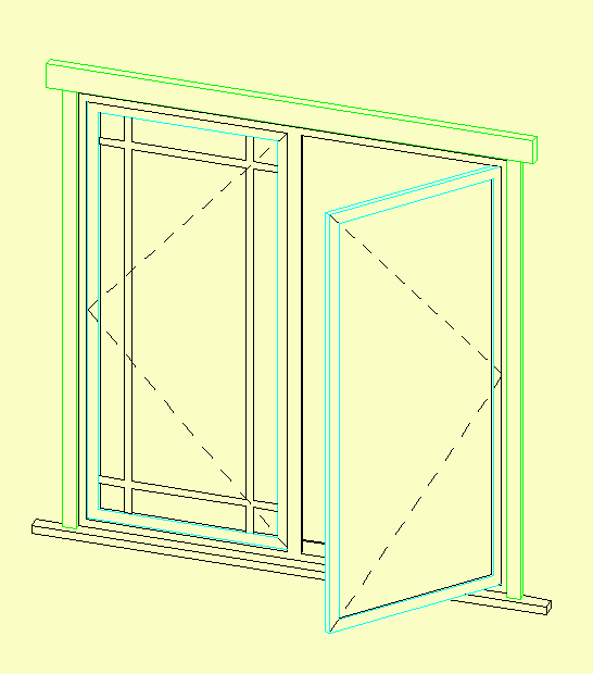

Jesikuh
Window options from DWB. You can assign any of these to any pane of your window. You have individual control of materials for each too.
I have only two gripes with DWB. I haven't yet found out how to produce sliding doors that meet at a corner with no frame, and sliding panels usually show on the wrong side (interior v exterior) in elevation / 3D views when they show correct on plan.
Oh, and the new scheduling method is crazy 'cos whenever you update your schedule you lose all formatting changes. So that's 3 gripes.
