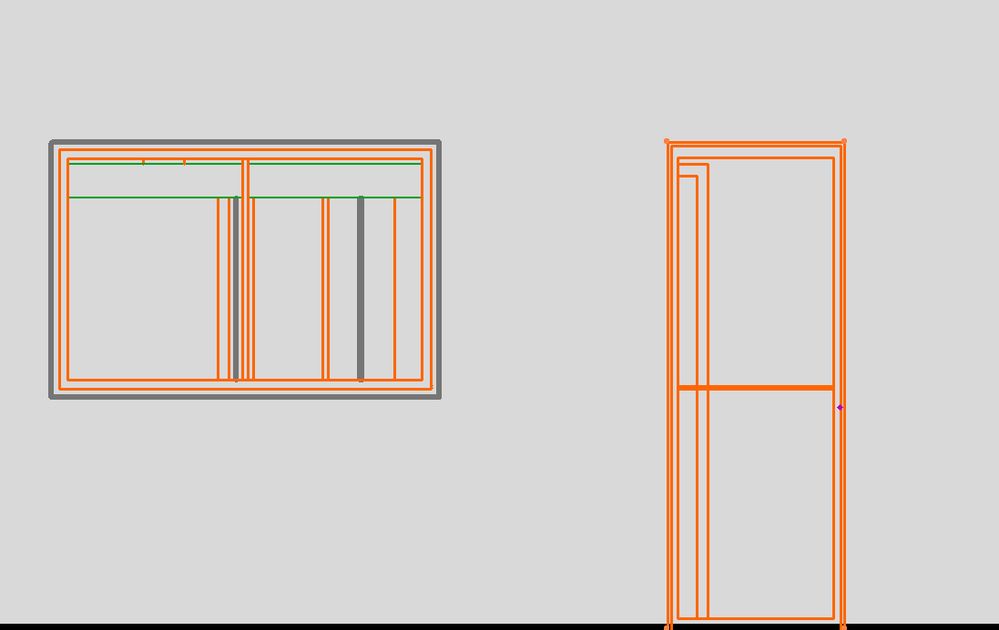

in elevations/sections I can see through doors and windows to the inside of the building. how do I change this so it will be permanent and will stay opaque on views and layouts as well?
I'm working with the 10th version

For ArchiCAD 10, go to the 3D Window Settings > Effects > Transparency in Shading and set it to Off. This attribute was moved to the Section/elevation settings in later versions.

thank you, but the problem is that when i move to another saved view, the settings change back to "on". and it affects the layout as well
Erika Epstein
You need to redefine all views with the incorrect transparency setting as David notes.

thanks. it works!
