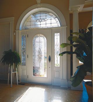

hi,
my boss is mad. can u help me how to create something like this?[/img]
now i had it from 3 elements.1 huge wide window,2 door and 3 above door circle window. but better will be to have it in one tidy elemnt in which i can change width of left/right glass panel, and above door to have not only half circle glass panel, but olso half elips.

I don't know if there is an door object with a round transom window, but you should be able to achieve this with two objects. Use the door with sidelights, and a half round window above. turn on the ganging option to make them join together more cleanly in elevation. and model some custom panels if the detailing of the doors and windows are critical.
