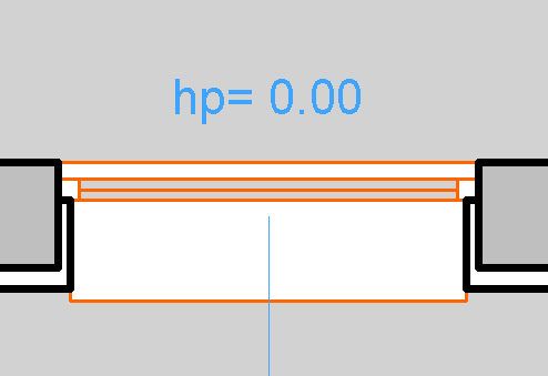

construction method 3rd
cavity closure - none
turn plaster - off (both sides)
a correct result
incorrect
what is the solution to get the same result in 11
cavity closure seems to have no effect in 11
it is not working
ac11-970 int, ac10, windows xp

i've tried all the 2d detail levels - they have no effect on the wall connection. It affects only the window symbol.
any other idea?
(the question was not clear. I was asking about the wall connection. the plan symbol is looking as it should, but the wall connection is not. I am trying to make the exterior skin to turn inside and it is not working. in ac10 it was working. and also the cavity closure in ac11 seem to have no effect.)

and the construction method is the third
I am trying to make the exterior skin bend on the reveal just like the "turn plaster" option, but with a different thickness. the firs picture that i've posted is what i'm trying to get.
any way of doing that?

any way of doing it ? (without patches)
there must be a way. it was working fine in ac10

I find and other problem:the carity clocery not work in 3d.
The wall in 2d like this:
