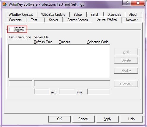

Under the server WkNet tab, clear the checkmark for Active:
This may be sufficient, but it doesn't hurt to go to the Network tab and clear all of the checkmarks for Subsystems: Local (kernel), WkLAN and WkNet :
