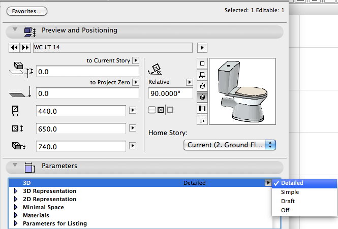

I am using version 14 and just on the drawing I am using at the moment, when I go to view 'Show all in 3d" it shows the walls windows, doors but no 3d objects like sinks, toilets, cabinetry and my floor slab?
I have tried:
Turning on all layers
Using a marque
selecting just some 3d objects
Is there a toolbar button I have accidently turned off?
Thanks

Just wondering if you have objects' 3D detail turned OFF, (but that would not explain why slabs are not showing).
If you select an object (sink or toilet etc) and go to its settings does it display in the preview window in 3D?

Maybe you are filtering these objects from you 3D view.
