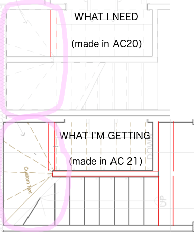

I am having trouble creating the winders the way I want them. I was easily able to do this in AC20, but with the new stair tool, I am now confused. I am making a new stair exactly as the one we already have, but I need to make some adjustments.
So, I want 4 winders, yet every time I try to do that, there is always a 5th riser right in the middle of the U-shaped stair. I attached two pictures to show you my problem. I don't know how I can go about remaking this AC20 stair in AC21. Does anybody know or have any ideas?

In AC20 and before, all custom stairs get saved as objects. But you can open these and adjust the settings. At the lower left corner of the stair settings dialog box you'll see "Edit Stair" if one is selected for editing, otherwise you'll see "Create Stair" if nothing is selected.
Issues with the AC21 stair are above my pay grade at the moment.
