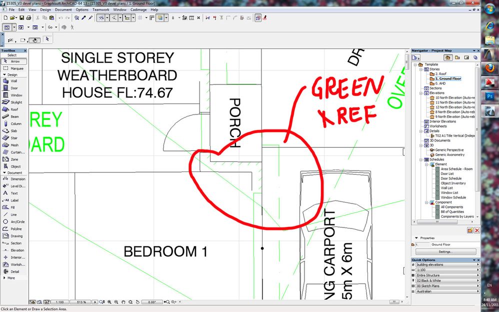

in archicad 13 we were able to use our scroll wheel on our mouse when clicked to see through to our xrefs behind what we were drawing.
this was very helpful to draw windows and see line work on different stories
is there any options to turn this function 'ON' in AC15?
the attached picture shows our green xref when the scroll wheel is clicked

What you have been accustomed to experiencing is the display of a "Simplified Model" during panning operations. You can pan with either the hand tool, or by pressing the center button of the mouse.
In Options > Work Environment > User Preference Schemes > Advanced Redraw Options, there are choices you can select for the model display during 2D navigation. The "Simplified Model" results in transparent fills, giving you the result that you want to see.
The default in AC 15 is "Full Model" - so that when you pan, you see everything with is normal appearance.
Just change that setting to "Simplified Model" and things should be back to the way you want. At least, testing with the 32 bit Windows version, it works. Hopefully 64 bit Windows is OK, too.
Mac users note: On my Lion machine, switching to Simplified Model still shows the full model during panning. It only shows the simplified model during zooming. Seems like a bug - maybe someone else can check?
