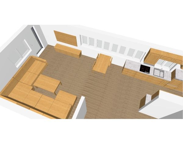

I was making my new home and for some reason everything went in oak like the kitchen?
Even the TV is in oak?
I have a dark sofa but in 3D it looks like oak.
If i use a new tool atomaticly it goes in oak.
Which settings have i changed?
Thanks for your help.
From a beginner in Sweden.

If this is only happening to Objects you may have the model surface override button pressed.
Thank you very very much, it was right.
Now i´m glad again.
