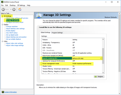

Thanks, I think it has helped a little. I will try local support too thanks for the advice. I am using a laptop Windows 11, with Intel(R) UHD Graphics, 8-bit, NVIDIA GeForce GTX 1660 Ti. Not sure if this is the reason to the problem.
OK so you have a built in card and a dedicated one which is a good thing.
I am not 100% sure of this, but basically you have to tell you laptop not to use the built in card but use the NVIDIA one.
Right click on your desktop and choose 'NVIDIA Control Settings'.
Then look at the following settings.
You have a much better card than I do!
I think you can also go into the 'Program"' tab and set up rules specifically for Archicad.
Or another thing to try is to make sure the drivers for your built-in card are up to date.
I remember reading in a post somewhere that can help.
