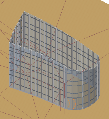

You can use the Mesh Tool, but it will be laborious. The image below was done by importing a mesh from another project (just to prove the concept), selecting the curtain walls as Targets, the Mesh as Operator, and Intersection as the Operation. The Mesh is on a wireframe layer in this image, it should be hidden.
If you want the Mesh as the roof, then copy the mesh, lower the copy by the depth of the roof, and subtract the upper Mesh from the lower Mesh to create a form of uniform depth.

I took a look at this object and there is no code in the Master Script, so this may be a translation bug (when I use the object in ArchiCAD 14, there is no error message), I don't see a way to fix the error message within the object's code. When zooming in on this object in section, it appears to have no depth, are you getting the depth you created for this object?
If you are able to get the depth to translate, and this object still does not work with SEO, then you could use a Mesh that roughly follows the contour of this object, remaining between the top and bottom surfaces, use this Mesh for the SEO, then hide the Mesh's layer.
