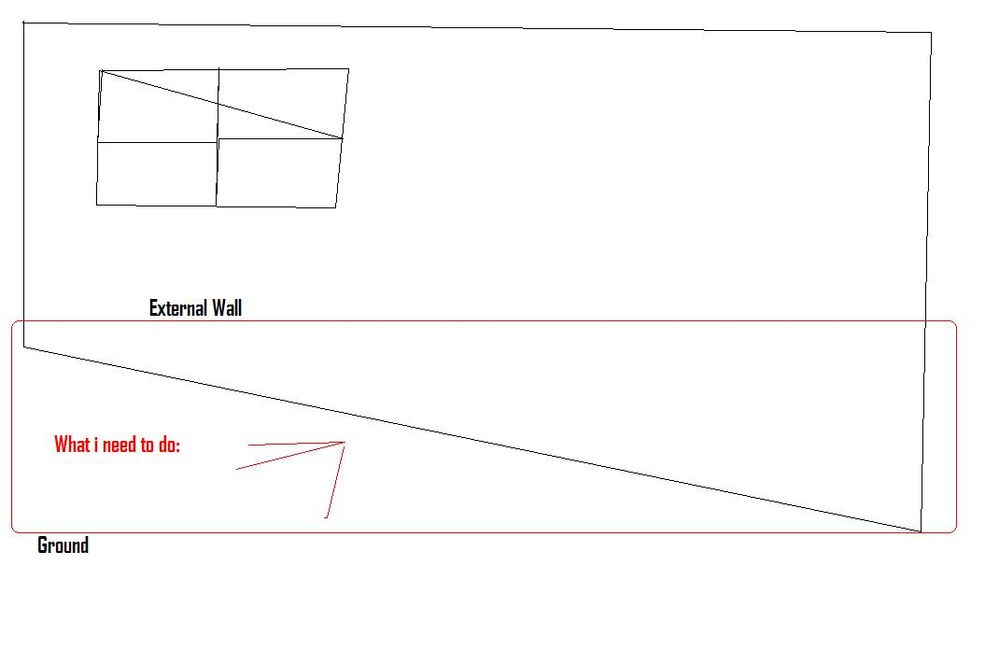

Hey, how do i create a wall in AC11 with a sloped base.
this is what i need:(see attached file)
Cheers

Thomas Holm
2ways:
1) Place a roof below the wall at the requested slope. Use the Trim to Roof command, Trim Base. You can delete the roof afterwards, or hide its layer. The cut will stay fixed until you click the Undo Roof Trim button in the wall's settings dialog.
2) Place a roof below the wall at the requested slope. Do a Solid Element Operation (SEO) , downwards extrusion, with the roof as operator and the wall as target. Afterwards, hide the operators layer. The cut will stay but move with the relative movements of the wall vs. the operator. If you delete the operator the cut will disappear.
