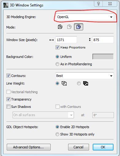

If you are in the regular Perspective view (where you work), you are in Open GL or Vectorial Engine. Go to the 3d Window setting by right click an empty space in the perspective window and make sure you are in openGL, in vectorial engine you won't see textures.

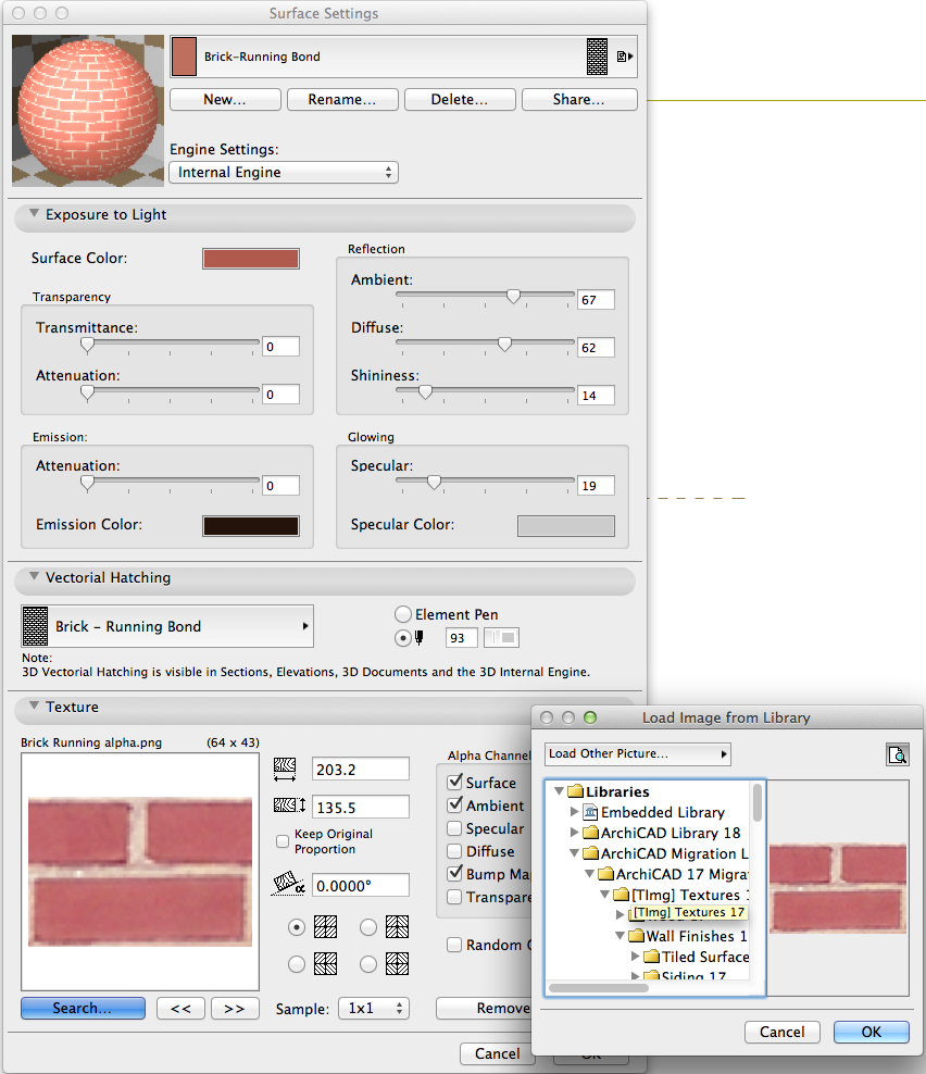

Go to Surface settings (Options> Element Attributes> Surfaces…) and make sure there is the image you want as your texture shown in the preview at the bottom of the dialogue in the Texture tab. If no image is visible click on Search button and find the image you want, which needs to be in a loaded library.
Near the top of the dialogue below there is a drop-down to change rendering engine (mine is on Internal Engine) where if you want the same texture image in photo renderings change to CineRender by Maxon and click on the Match Settings button.
Hope this helps.
