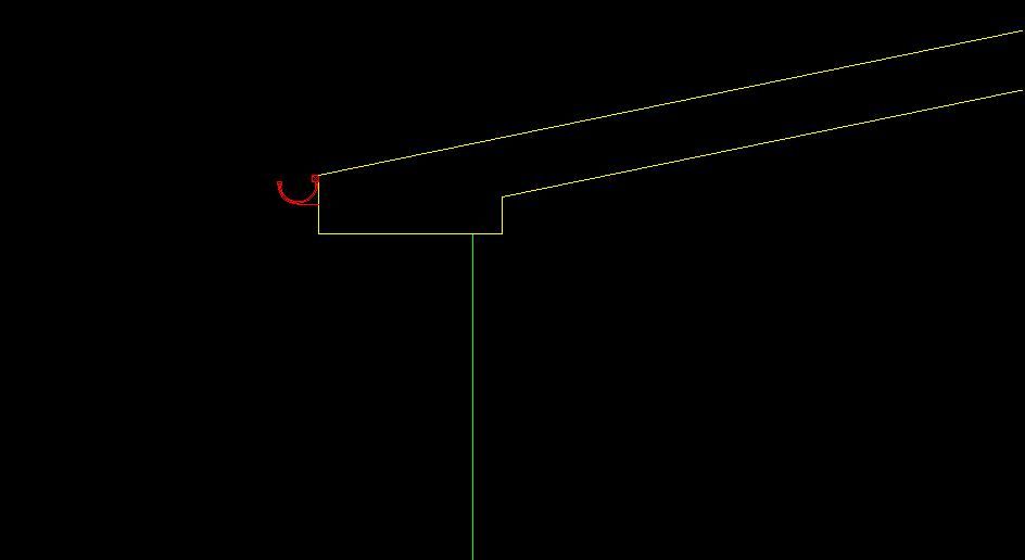

Does any one have any ideas on how I could achieve fascia detail as seen below.

For the specialized fascia profiles you've mentioned, you can use 'Tools/Profiler' to draw the profile and the path on your drawing using 2D drafting lines and arcs etc. The profiler will then combine these into a 3D symbol.
The geometries are a bit unituitive but works OK once you've figured out its idiosyncracies.

Actually, your fascia profile looks so simple, that just doing a Solid Element Op "add" of a slab should do the trick. (The add gets rid of the internal lines when you cut a section.)
For the gutters, consider the rxGutters add-on from www.arexline.com

The SOE tip is a good one.
But I'm generally not really a big fan of Add-ons for such arcane things as eaves.
For starters, you can do most of what you need within AC. And secondly, the more esoteric Add-ons aren't that well supported and tend to be buggy and may not be around 2 versions down the road (or even half a version down the road). Not a problem if you're doing a one-off project but hugely problematic if you're doing an ongoing refurbishment of an historical building (which is probably the only reason you'd need a specialized eaves Add-on anyway!!!)
