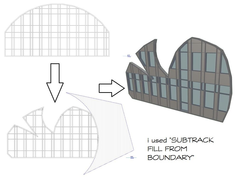

Read Archicad help...press f1...there you have pictures too

look at capture of screen !
this window is view in elevation of CW.
i just copy in photoshop plan view and location of elevation. You have to do same...if you are still stucked - write
pic 2
