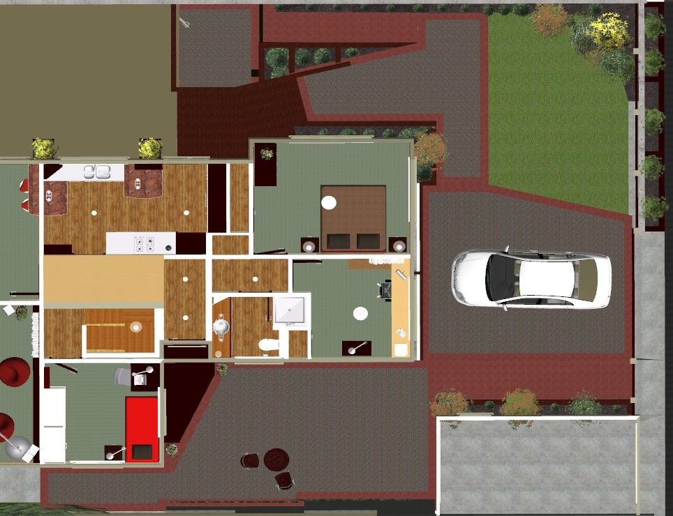

Here's an example of what you can get with an Axonometric view...
...vs 2d Plan view (with the use of Cover Fills; Pensets... and Symbolic Cuts for elements that don't support Cover Fills e.g. Walls).
I use an expanded penset that has groups such as FURNITURE (green); FOLIAGE (browny green); HARDSCAPE (mostly greys for concrete and pink for clay); JOINERY FITTINGS (pink); METAL FITTINGS (Silver); EXT TIMBER (Dark Brown); etc.
This way, elements mostly get assigned to pens that reflect their actual colour (concrete=grey; foliage=green; etc), and where colour can vary, e.g. furniture, a colour is assigned to a group's purpose (green for all furniture).
And for less of a "presentation" look...
By a simple swap of a Penset, in a different view or drawing on a layout, I can get rid of - or simplify - all the colour, if need be. I can also not show any fills too, using the View or Drawing's "Model View Options".
And since AC13, you could even use image fills for more "realism".
