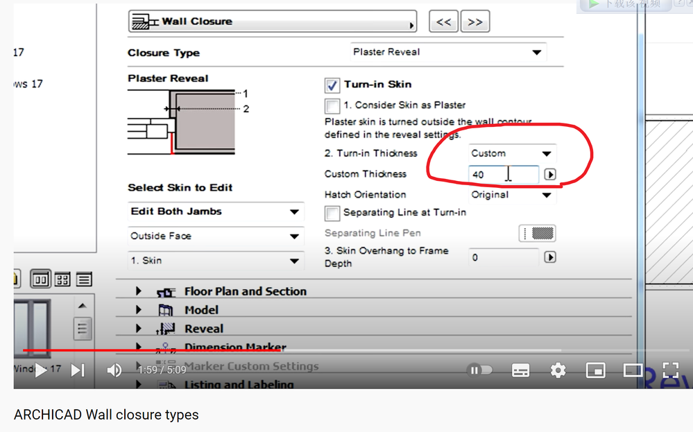

Hi guys, I met a problem. I can't set different thickness of the wall closure. As shown in pic below, How can I set thickness of "b" not equal to "a"? Thank you !

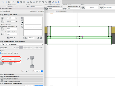

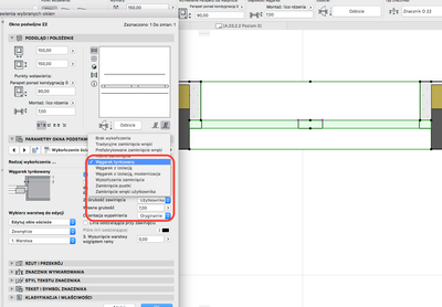

I do it like this
This the same thickness
Sorry for language, but in this moment I have only polish version.

Andrii Levko
I do it like this

William Yan
WOW THANK YOU! You saved me Andrii! The secret is to use the wall reveal along with the custom closure and it's thickness must equal to the custom thickness!😀

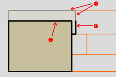

New problem here! How to set the closure line thickness same as the outer line of the wall? pics in the following reply.
AC 26 5002 CHI, Windows 10
William Yan
Dear Andrii, New problem here! How to set the closure line thickness same as the outer line of the wall?  skin line 1 and 2 should be the same, and 3 is the thick wall cutline
