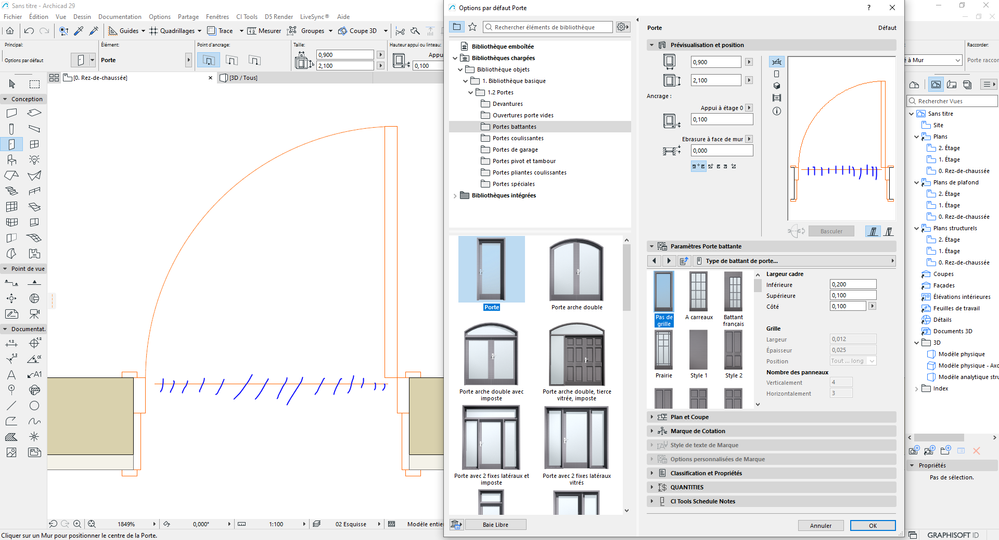

Incorrect plan view of a hinged door with a glazed door leaf
I think there's an error in ArchiCAD 29, or perhaps someone has a solution. Specifically, when using a hinged door and selecting a glazed door type, the plan view is inaccurate due to a line that appears and disrupts its readability. However, if the selected door type does not include glazing, the plan view is correct.

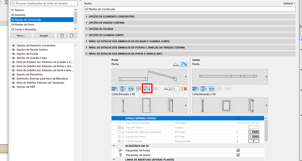

Hi @DOUGBE
Check your VMO MVO, turn this icon off and you should be fine.

Hi @DOUGBE

DOUGBE
Thank you very much!
