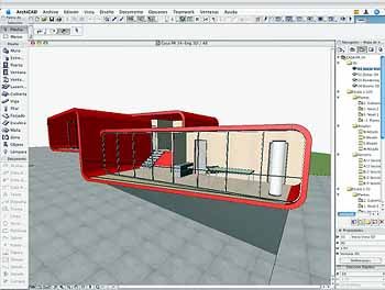

i would like to know how to create a building similar to the PR34 house.i want to create a flowing wall which has 2 floors.please

Custom profiles are your friend.
thanks alot how can i insert windows the same shape
Unless you know GDL, you may need build custom windows using slabs/walls to get the curved corners. See the section on 'Graphic Creation of Custom Objects' in the reference guide for instructions. (See p233 for AC11, or p322 in AC12.)
As I recall, that's how Michel's office did it. I think it was in ArchiCAD 8.1.
