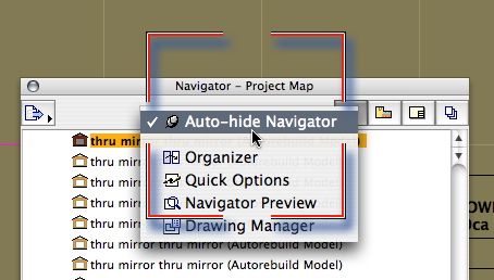

open the navigator and RIGHT click on the blueish icon in the
upper right corner and un-check the "Auto hide Navigator" check box.

Since i finished the screenshot solving this problem anyways, here it is.
Users might note that many navigation and dialog box perferences can be accessed through the context (generally right click) menus.
