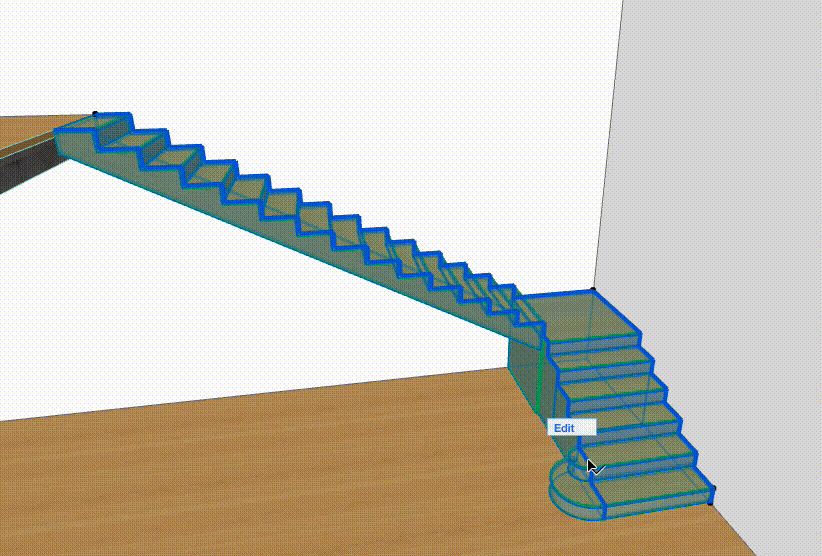

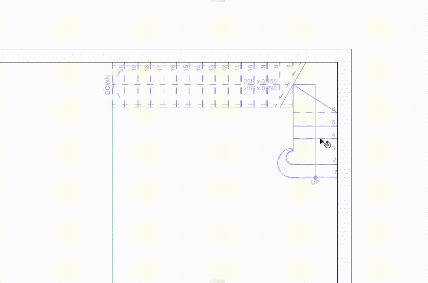

  • In order to make the Railing associative, we have to add an extra Node for the Railing to relate to. To do so, select the Boundary line and add a Node with the help of the Pet Palette.
  • You can see, how the newly added Node appears in 3D as well. Use it as a starting point and add a railing to stair. You only need to click once at the beginning, at twice if you're finished.
